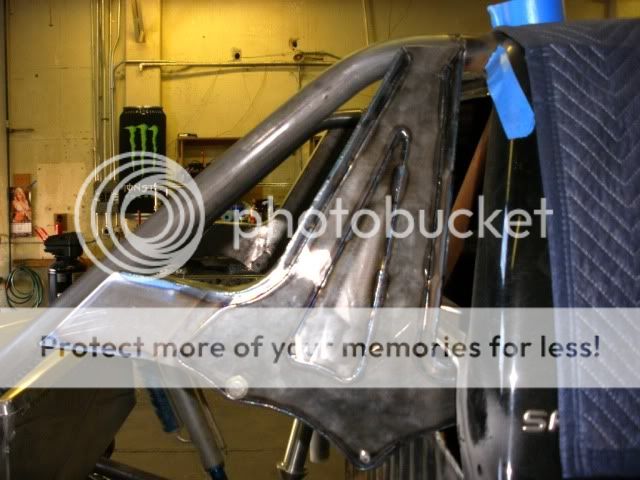

Postby socalmoto » Mon May 02, 2011 6:43 pm
Been a little . . . pulled all the tube work apart and welded the backhalf all together. Had a couple quick bumper jobs to get done, but now back to business.
Heres the intersection at the c pillar.
Then welded the body up so theres no leaks.
Got started on the lightbar too.
